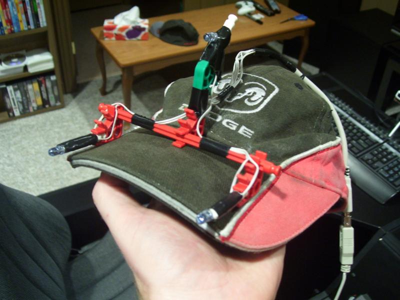

Erre gondoltam. http://www.free-track.net/images/point_model_gallery/neron_02.jpg
